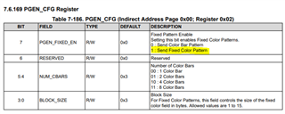

Now I use 1280x720p30   2  data LANE  800MHZ  RGB888  mipi csi 0
Then I use gstreamer display DS90UB954-Q1 pattern mode  in our LCD ,it dispaly grey
you can check
There are my i2c cmds

    Can you get a register dump of the patgen page once you have finished programming? Can you complete the below table so I can work on getting a script with all the settings?
    PATGEN Output
    Horizontal Resolution 1280
    Vertical  Resolution 720
    Total Vertical Blanking  ?
    Vertical Front Porch ?
    Vertical Back Porch ?
    Vertical Sync  ?
    Frame Rate 30
    Video format RGB888

    The 954 data sheet mentions the reference color bar along with that two patterns which are supported- reference color bar and fixed pattern. The provided color bar is the black and white that we have. Can you use RGB 565? This one would have color.
    For getting a full screen color (blue), need to change the block size to 3 (for RGB888, it’s the default as well), enable fixed color pattern 0x02[7]=1’b1 and change color 0,1,2 to (0xFF, 0x00, 0x00 for blue)- RGB88 inverts the data thus the sequence is BGR for byte n,n+1 and n+2.
    Glenn
