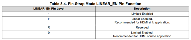

I use TDP0604 as DVI level shifter.
Please help to review schematic.
I have below question.
1.The panel is HDMI v1.4b up to 3.4 Gbit/s per lane, so I think CTLEMAP_SEL is  MAPB. Am i right?
2.LINEAR_EN: TDP0604 sink HDMI signal form SOC, and transfer it to connector. Pin LINEAR_EN should be set 1 or 0?

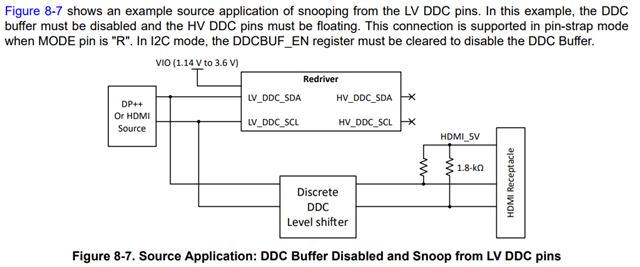

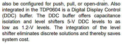

3. DDC Function: My colleague suggest me to add a DDC lever shifter(U122). Does TI suggest add lever shifter in my design? If yes, should I set Pin mode to R DDC disnable?
  • Hi Gino,
    1. Yes CTLSEL MAP B should work for that data rate.
    2. Since the TDP0604 is between the HDMI source and connector, this would be a source application. I recommend using limited mode by setting LINEAR_EN to '0'
    The benefit of limited mode is having the option to adjust your signal pre-emphasis via the TXPRE pin and the signal swing via the TXSWG pin.
    3. TDP0604 has an integrated DDC level shifter so you may not need an external shifter.
    I recommend reading section 8.3.12 of the datasheet for more info on the DDC buffer/level shifter to see whether it will work for your application. If you do use an external shifter, you should allow the TDP0604 to snoop the DDC lines through either the LV or HV DDC pins. If snooping through the LV pins, you should disable the DDC buffer by setting MODE to 'R'. If snooping through the HV pins, you should enable the DDC buffer by setting MODE to '0'
    I have a couple comments on the schematic:
    • You route the DDC lines through the TCA9509DGKR instead of through TDP0604. If using an external level shifter/buffer, please follow the LV or HV snooping diagrams in the TDP0604 datasheet (LV example shown below). This allows the TDO0604 to snoop the DDC communication:
