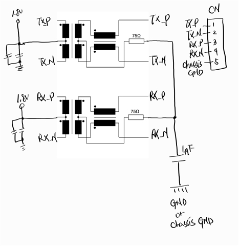

Hello.
I am currently designing an EtherCAT using the DP83822IH.
I am writing this to seek advice regarding EtherCAT design. To implement the minimum number of pins, I plan to use only 5 pins for the EtherCAT connection (TX +/-, RX +/-, Shield GND) with a separate connector instead of an RJ45.
After using a transformer, I am considering connecting the secondary side, which should originally connect to RJ45 pins 4, 5, 7, and 8, to GND or chassis GND. Would this be acceptable? I would appreciate your advice.
Thank you.
