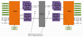

I am Looking for TI Chip that will best fit to the following application. (see attached block diagram)
The requirement is to pass different signals with different bandwidth and asynchronous to each other, on a single coax.  The way is to aggregate them and pass then on single Coax cable that farther on will pass via rotary joint or slip ring devices. Thus, reducing the rotary joint and slipring size/nodes/cost comparing to passing them without the aggregation.
It is preferable to have the chip to be bidirectional so to have TX and RX on the same coax. So that single coax will be used.
The maximum aggregate rate can be less then 200Mbps but prefer to have 1G to 3Ghz rate.
I have added the block diagram of the solution that based on FPGA that on the TX side samples the signals/buses and put them on a single output. That output together with clock will be fed to TI chip that you will recommend me and will interface to the coax cable.
On the Rx side the chip will receive the data from the coax cable and provide the FPGA with the recovered data and recovered clock , the FPGA will extract the data from the aggregate input and recover all the signals.
The length of the cable is max 3 m. But I will prefer the chip to have pre-emphasis and on the receive side equalizer.
Also, in order to have eliminate DC on the line scrambler and de-scrambler is needed.
Please suggest a chip (for Tx, and for RX)  that can best fit to this application.
(chips that I have check but not really fit are the   : DS32EL0124 , DS32ELX0124, LMH0341/041/071/051 or the LMH0397, DS25BR100 none of them seems to match)
Note that the application requires clock to sample the incoming signals and need to be recovered on the other side, That is the reason that I hardly see the   FPD link 3 serializer DS90UB913A-Q1
As a candidate)
Also note that the application is not for video transfer and the aggregated data is not coded at all. (for example, it is not SMPTE compliant)
  Avner

  • Hi Avner,
    What type of data is the SERDES expecting to receive and send? I only se TXCLK and RXCLK.
    Gil Abarca
  • Hi Gil,
    The Overall system should pass various signals from simple discretes with rate of change of seconds, RS422/ RS232 serial communication of rate of 115200 Hz, and if the serdes should be fast enough even to pass higher signals such as CAN bus or even ethernet up to 100M.
    The serdes may have several ports. All of them will come from the FPGA.
    Now the method I thinking of, is to sample the signals inside the FPGA, the slower ones,  such as discretes to aggregate  into  single line,  other signals which are faster will be just sampled and passed to the SerDes.
    The SerDes function will be to be able to interface coax line and to be able to recover the data using CDR also to make sure the data will be scrambled so to reduce DC bias so in order to properly recover the data passed on single coax.
    If possible to have both TX and RX on the same coax otherwise to have the system doubled and have 2 coax lines one for RX and the second for TX.
    Does that makes sense ?
    Since the purpose of the design is to make the slipring removed, or make it smaller in capacity of signals transferred, there is no streak restrictions. Any major reduction of signals having our best effort will be acceptable.
     Avner
  • Hi Anver,
    We have a serdes that accepts parallel data and output parallel data. Can you take a look at DS90UB925-Q1 and DS90UB926-Q1. SInce they are parallel input then it should allow you to pass any signal and not just RGB data.
    Gil Abarca
