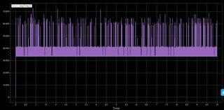

We have a new design, see the picture below,PCIEx16 access to PEX8748 by a cable, and then, a PCIEx1 port of the PEX8748 access to XIO2001, then expands several PCI slots.

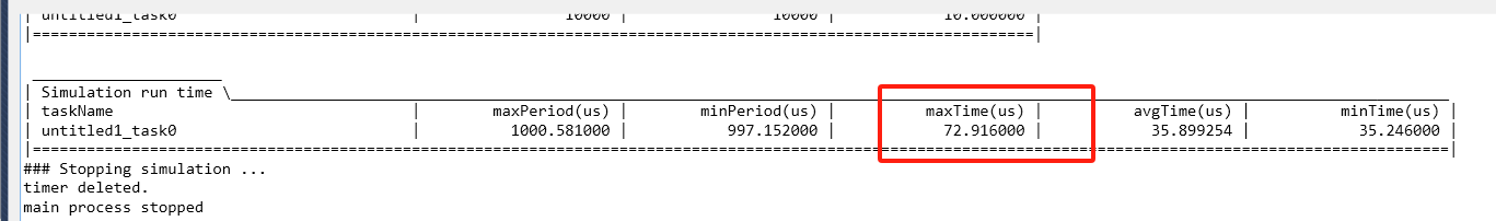

The problem is that we read or write PCI slot devices through the CPU, and the read and write time is unstable, see the picture below, most of the time is about 35 us, sometimes it will jump to about 70 us, we want it to be stable at about 35 us.
Can you give us some guidelines? How can we solve this problem ,or which direction should we try to solve this problem?

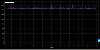

    1.Yes,we checked other ports of PEX8748,it is about 18us,see the picture below.
