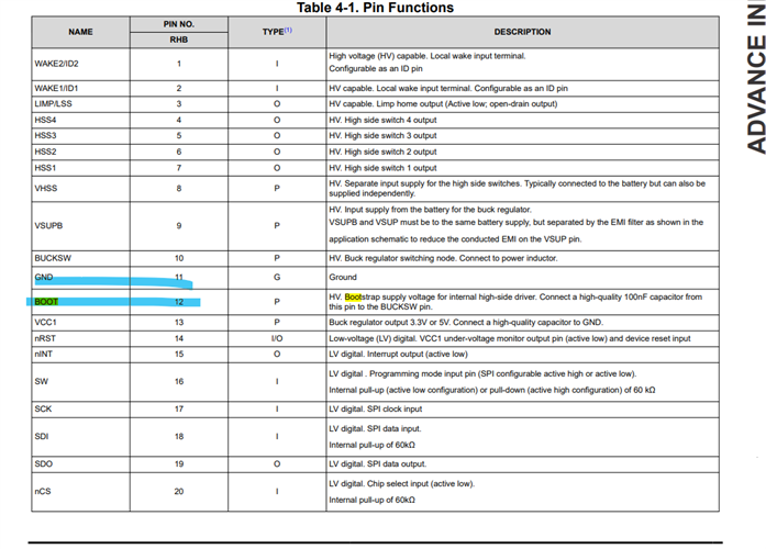

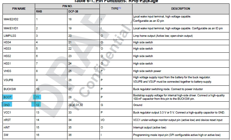

Dear TI experts,
My customer asked about the difference between draft datasheet and current datasheet. Please see the pictures below;
- Draft datasheet (Received from local TI representative)
- Current datasheet (in the product page)
Could you confirm that which one is right descriptions?
