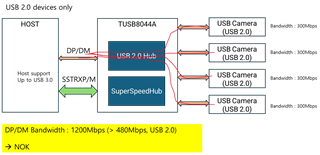

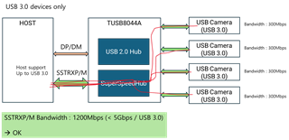

TUSB8044A: Inquiry about TUSB8044A Bandwidth
Part Number: TUSB8044A
First of all, I would like to mention that I do not have detailed knowledge about USB. Therefore, the block diagram below is just my assumption. If there are any mistakes, I would appreciate it if you could let me know in detail.
Will the data be transmitted separately depending on the USB version of the devices connected to the downstream ports of the TUSB8044A in the three cases below? In such cases, it seems that there may be a limitation on the bus bandwidth depending on the minimum transmission requirements of the devices.
