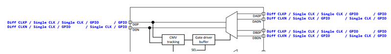

This is an inquiry regarding the usage of the TMUXHS4412 Single-Ended.
We are considering using it in connection with the FPGA's IO channels.
Depending on the operational functions of the FPGA, we are planning to use the same channel as shown in the image below. Could you please confirm if this is possible?
    You could use these pins for GPIO, yes. Typically, we only recommend using the positive lane if you are going to send a single-ended signal through the channel. The negative lane can be left floating.
    Another thing to keep in mind with these channels is the max supported voltage on the I/O. This mux cannot support signaling up to 3.3V if needed.
    I would just like to clarify, with these signals listed in the image, are you saying the lane will send diff CLK, and sometimes switch to other signals? Or are you just trying to determine what signals each channel can send?
    Ryan
    Thank you for your response.
    The voltage of the signal is below 1.8V.
    As described in the blue text of the image mentioned in the previous question, the FPGA output switches signals on the same channel depending on the function settings.
    The FPGA channel is configured to switch between Diff CLK, Single CLK, and GPIO functions depending on the usage scenario.
    If only the positive channel is used and the negative channel is left floating, is it possible to use the CLK signal down to the DC level?
    I am wondering if connecting only the positive channel to the FPGA would allow the use of Diff CLK, Single CLK, and GPIO (DC level) altogether.

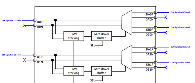

  • Hi Ryan
    How do you mean? Like, have the CLK signal no longer alternating to where it is just a flat voltage/current?
    It was a question about whether it is possible to use it as shown in the image below.
    We are reviewing the alternative part TMUXHS221.
    Your response was very helpful.
    Thank you.
