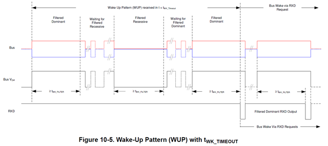

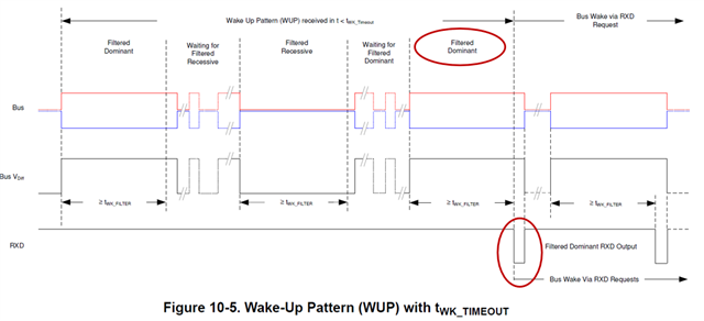

 i saw the following picture in our datasheet. RXD is high during "Filtered Dominant RXD Output" in the below picture.
i am thinking if Recessive signal happen in "Bus Wake via RXD Request" whether RXD should be low during  "Filtered Dominant RXD Output" ?
thanks

  • Jay,
    If the device is still in Standby mode after the initial wake event, then RXD will toggle low after the bus has been dominant for tWK_FILTER
    customers want to get long duration low level. so it seems like we need to more time duration of second Filtered Dominant. so what is maximum limitation duration time of  second Filtered Dominant
    The maximum time is the tDTO in the datasheet. This is how long TXD can be held dominant. If the TCAN1048AV-Q1 is acting as a receiver, it can be held dominant indefinitely, it will depend on the limitation of the node transmitting at that time.

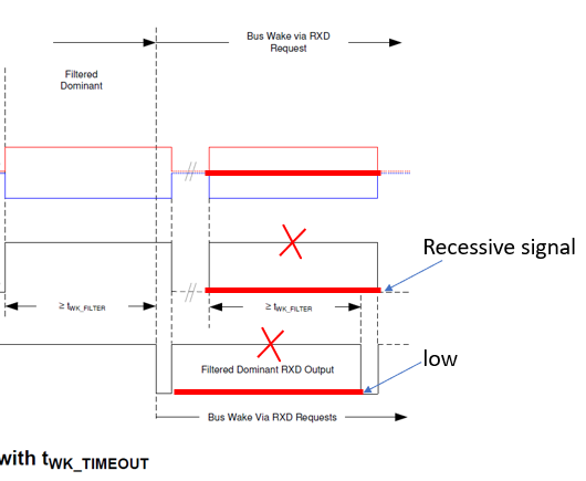

  • hi Eric
    thanks for you quick reply. i don't understand this word.
    i draw the following picture. Am i right?
  • Hi Jay,
    While the transceiver is in standby mode and the WUP pattern has been detected, the RXD pin will be able to assert low to indicate when the CAN bus is in a dominant state. This dominant indicator has a filter time of tWK_FILTER - therefore the CAN bus will need to be dominant for tWK_FILTER before the RXD pin asserts low. Once this filter time is reached, the RXD pin will remain low until the CAN bus returns to a recessive level or the dominant timeout is reached (it is unlikely a DTO will occur during normal CAN communication).
    Note that other single-channel 14-pin CAN transceivers may have slightly different behavior here where the RXD pin latches low after a WUP is detected and will remain low regardless of the state of the CAN bus. This is not typical behavior for 8-pin CAN transceivers like those that TCAN1048 is modeled after.
