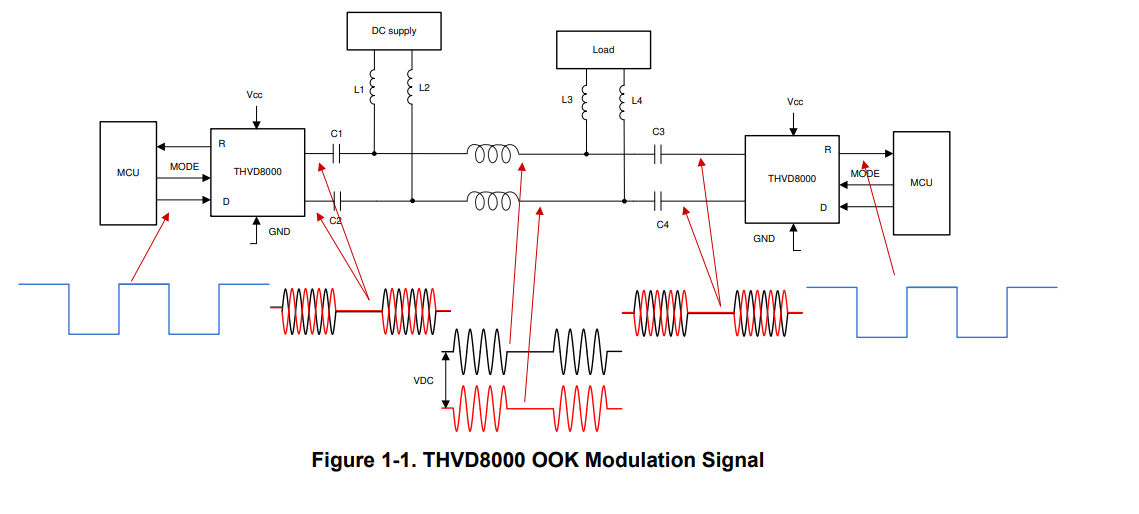

Hi experts,
I want to know the input impedance of THVD8000 in receive mode. As I know the RS485 related standard specifies unite load of 12kohm. May I think the input impedance of device in receive mode should be >12kohm? (@5MHz fc).
Another question, considering the input is AC coupled, is it necessary to design a bias network to bias A/B input to a known DC level?
Thank you!
John
  • Hi John,
    This device is 1/8th unit load - so we estimate the minimum input impedance at 12V input to be 96kohms (1 unit load is 12k - 1/8th Unit load is 8 times more resistive so 96k) - generally the input impedance is higher than 96k during operation.
    No bias circuitry is required to bring device up to known DC level - output is balanced with logic 0's being transmitted as a pulse train and logic 1's being transmitted as a 0V differential.
    For standard operation the only external components explicitly needed on the bus are the coupling network inductors and capacitors (below is a two node system example - more nodes can be used than 2 - but basically every node is going to be extremely similar):

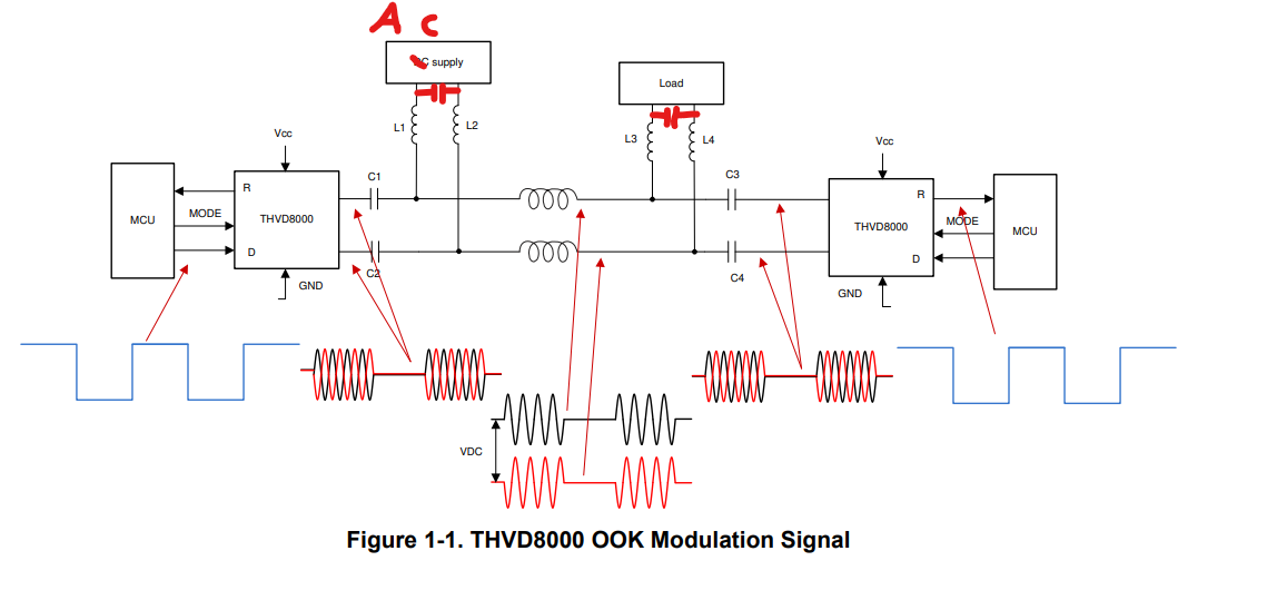

    Above is for a DC power system - for lower voltage AC power systems (<=36V) there is the need to add a filter capacitance across the main power supply to mitigate OOK signal from leaking to the power line.
    It is also generally a good idea to add a termination resistor between A and B pins of THVD8000 for both start and end node - usually 120 ohms - but this isn't as necessary in THVD80x0 applications because the cable is generally not impedance controlled - however it will help with some noise issues.
