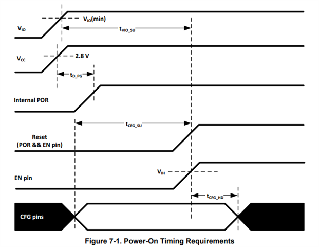

Part Number: TDP1204
HI team,
Does the device have shutdown sequence or reset sequence? because I found start-up sequence in the datasheet.

Hayashi-san
There is no power down sequence requirement for TDP1204.
