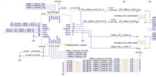

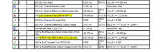

We are using the TUSB522P between the Host and the connector. During the USB 3.0 compliance testing, several tests failed.
Please refer to the attached document for details. Total Jitter fail.
 USB3_CC1.pdf
Currently, our EQ/DE/OS settings are as shown in the schematic. Do you have any suggestions on how to modify these settings to improve the test results?
PIN DESCRIPTION LOGIC STATE TYP UNITS DUT configuration
1
DUT configuration
2
EQ1/EQ2 Receiver equalization amount Low 3 dB
Floating 6 dB
High 9 dB V V
OS1/OS2 Transmit output swing amplitude for the transition bit Low 0.9 Vpp
High 1.1 Vpp V V
DE1/DE2 Transmit de-emphasis amount Low 0 dB
Floating -3.5 dB
High -6.2 dB V V
Thank you
