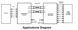

According to the applications diagram above, what I need to do first is to use test code (or existing code) on the Processor (TDA4) side to display pictures or videos on the LVDS Display or Graphic Processor side. If there is such test code, please provide it to me.
Ub941 serializer is available on the EVM, but we have not tested/validated ub948 deserializer. I am not sure if any display card available for ub948.
Brijesh
Sorry, this is not supported in the current SDK, as far as i know, there is no plan to add support of UB948 deserializer in the SDK.

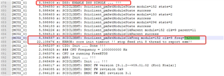

Which SDK release are you using? Have you made any changes in the RTOS SDK, like have you added support for RTI in the RTOS SDK? This is because i dont see this error message anywhere in the SDK.
Brijesh
Hi
I don't know.
How to remove support for RTI in the RTOS SDK?
Fuguojia
Hi Fuguojia,
I searched in entire RTOS SDK, but could not find this statement "core init timeout", so is this something added by readauto?

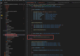

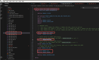

This is supported in the RTOS driver, ie when you use vision apps. So no change required in the device tree. You would just need to set the output to DSI in app_common_mcu2_0.h header file and then follow the build process mentioned in the RTOS SDK.
I use the SDK version of TDA4VM_SDK_10.05. Set the output to DSI in app_common_mcu2_0.h header file as follow:
I've read the registers 0x5a and 0x5f of the UB941. Their values are as follows: the value of 0x5a is 0x02, and the value of 0x5f is 0x00. It seems that the current SDK isn't sending DSI signals to the 941. How can I modify the code to send DSI signals to the 941?

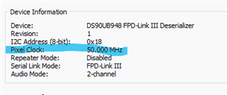

Hi
I've tried two resolutions,and I also read the DSI_VID_MODE_STS_FLAG register on the SoC at the address 0x04800180.
One resolution is 1280 * 800, and in this case, the value of the register always remains 1. The other is 1920 * 1080, and then the value always stays at 5.
Fuguojia
Hi Fuguojia,
1280 x 800 resolution is validated on EVM, so you should see output at this resolution and even VID_STS register confirms that it is streaming out the data.. Do you see any output from UB948?
