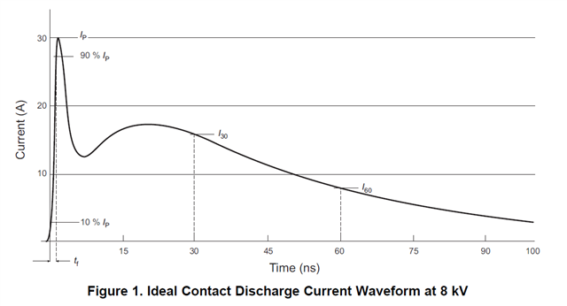

    No, the HBM and IEC 61000-4-2 are two different standards. HBM and CDM we listed in the TMDS1204 datasheet are intended to ensure the IC survives the manufacturing process. HBM is usually sufficient for controlled environments but it is inadequate for system level testing. The system level testing required is the IEC 610000-4-2 which is more stringent than HBM. The main difference between the two are:
    • The amount of current released during a strike
    • The rise time of the voltage strike
    • The number of voltage strikes repeated in the test
    For the IEC 61000-4-2, there are four levels with 2kV, 4kV, 6kV, and 8kV. With the IEC61000-4-2 being a system level testing, an overall system level ESD protection solution is required. Since we have no control over the specific IEC level requirement, or the ESD protection diode being selected, we put in the datasheet the Resd recommendation. Besides the ESD protection diode, the role of Resd is to limit the amount of ESD currents to provide an extra level of ESD protection. So besides the ESD protection diode, the customer can tune the Resd in order to meet:

    Almost any ESD TVS diode limits voltage impulse a lot. If we have 8 kV (IEC-61000-4-2) on a connector, "after" ESD VTS the voltage pulse will be... let's say no more 10V for most cases during all time. IEC-61000-4-2 define
    Following IEC61000-4-2 the time domain (I see it's current not voltage):

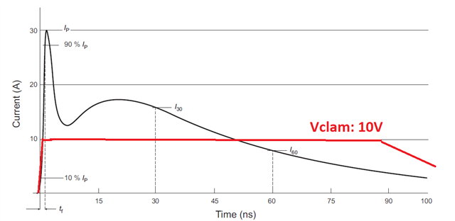

    So, then we can say that ICE-61000-4-2, 8 kV impulse has a similar duration, but the voltage is limited by TVS. Let me very schematically draw a voltage line (for no snapback device) on top of a current line:
    I suppose internal ESD HBM protection of the TMDS is also kind of TVS. I understand that two parallel TVS with no resistance between them don't work as separate devices. But, for such a fast-rise edge (ESD pulse), an inductivity is probably even more resistant than 0R...2R resistor. Maybe the final max voltage on the pins of the re-driver is bigger than 10V, but I am pretty sure it's much more smaller than 500V defined by HBM.
    So in my mind looks like, internal ESD HBM protection should be enough to block the rest of ESD impulse energy "after" any HI-speed TVS that I know.

    The issue here is that we have no control over the ESD protection diode selection, the ESD layout design, or the actual ESD event, etc., as it is a system level design and event. But at the same time, we need to ensure that the TMDS1204 itself is not going to get damaged from the ESD strike. For example, if someone picks an ESD protection diode with clamping voltage of 12V and the ESD event is at 10V, that ESD protection diode will not clamp and present a low impedance path to shunt the Iesd to GND. In this case, the 10V ESD will present to the TMDS1204 output. The HBM and CDM we listed in the TMDS1204 datasheet are intended to ensure the IC survives the manufacturing process, HBM is usually sufficient for controlled environments but it is inadequate for system level testing. The TMDS1204 output I/O is also not designed to withstand the 10V ESD strike, so most likely the TMDS1204 IC will get damaged from this particular ESD strike.
    So we put in the TMDS1204 datasheet the recommendation of "It is recommended that the ESD protection component has a breakdown voltage of ≥4.5V and a clamp voltage of ≤4.3V" as a way to bound the ESD protection diode selection. And for "A clamp voltage greater than 4.3V will require a RESD on each high-speed differential pin" is to ensure the TMDS1204 output I/O will not get damaged from an ESD strike of less than 4.3V with the Resd providing the majority of ESD protection in this case.
    You are correct that the Resd will present additional insertion loss and return loss, so the recommended Resd is 1 or 2ohm to minimize the insertion and return loss as much as possible. The selection of Resd is such that:
