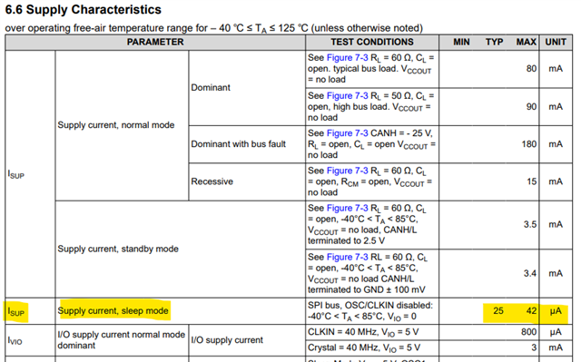

We are using TCAN4550-Q1 part in our design. Since the product is battery operated device, we would like to confirm the current consumption in sleep current mode from the Vsupply.

Hi Stanley,
Thanks for reaching out. In Sleep mode the typical current consumption is 25uA with a maximum of 42uA.
Let me know if you have any other datasheet questions,
