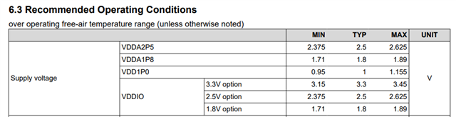

My customer is designing a board using the DP83867IS.
If there is a power sequence recommended by TI for stable operation of DP83867IS, please let us know.

    Recommended power sequence will depend if customer is using two or three-supply configuration.
    Please refer to section "8.3 Power Supply Recommendations" in datasheet for details on recommended sequence depending on mode.
