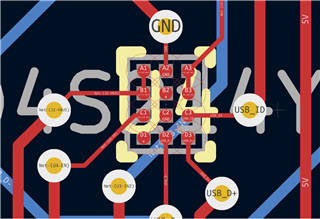

this may be a silly question, but I don't know how I should connect the PIN C2 which is GND, no track can come out to connect it to GND. can someone clarify me if I should leave it that way?

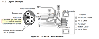

This part is designed for PCB's that can support 10 mil pad and 6 mill drill Vias and via in pad, so the via has to be filled or tented. The GND via for C2 has to be VIA IN pad.
The layout example shows this connection, but not as clearly as may be desired.
