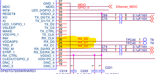

    Is the PHY configured for SGMII via bootstrap?  Please provide the configuration for pins 24, 25 and 26.  The default state for SGMII is for these pins to be floating.
    Please check the SGMII_CTL_1 register status(Register offset 608h), in particular bit 9 (cfg_sgmii_en) to see if SGMII is enabled.  Also, please check bit 0 of the same register, this bit should normally be set to 1 to enable SGMII auto-negotiation.
    Also, do you have schematics you can provide to review?

  • Hi David,
    The above picture shows the register 0x608, where the bit 9 and the bit 0 are both 1.
    The above picture is our schematic for DP83TG720, where the pin 24, 25, and 26 are all floating.
    Philip

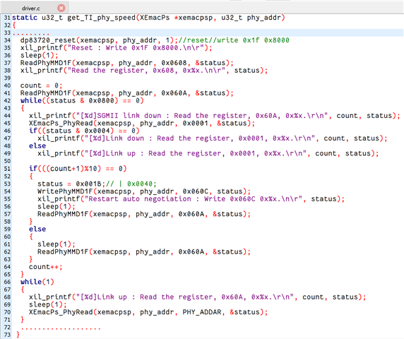

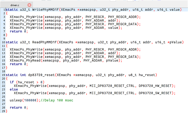

    driver.c :
    Philip

  • Hi Philip,
    Since the processor does not support auto-negotiation, we recommend disabling auto-negotiation in the PHY.  SGMII Auto-Negotiation can be disabled by setting bit[0] = 0b0 in the SGMII Configuration Register (SGMIICTL, address 0x608).
    Also, in the driver code to reset the PHY can you change to a Soft Reset (Reg 0x1F, bit 14).
    Note, although we are removing the auto-negotiation, the code above appears to write the default value of this register and has the value to restart SGMII auto-negotiation (0x0040) commented out.
    Undrea

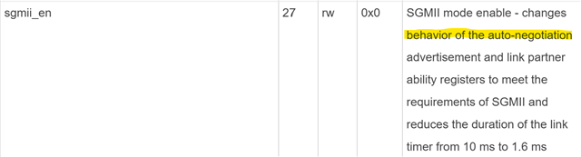

    In our platform, there is a register with sgmii_en bit, whose description is shown below :
    Surf the link https://docs.amd.com/r/en-US/ug585-zynq-7000-SoC-TRM/Register-XEMACPS_NWCFG_OFFSET-Details for details.
    Does it mean the SGMII of the MCU supports auto negotiation?
    Philip
  • Hi Philip,
    I don't see anywhere in the document that explicitly states SGMII auto-negotiation is supported.  As pointed out in a related document, when SGMII is enabled, there is no auto-negotiation.  I take the register description above to mean that the controller changes what is advertised(From auto-negotiation enabled to disabled as it would be enabled in RGMII). It would be best to check directly with AMD.

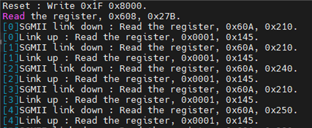

  • Dear Undrea,
    I tried the changes suggested last week, but the SGMII link status is still down.
    The procedure is as below :
    1. write the value, 0x4000, to the register, 0x1F.
    2. write the value, 0x0278, to the register, 0x608,
    3. read the value form the register, 0x60A, and check the bit 11 of the value.
    I kept read the register, 0x60A, and check the bit 11 every second, but it was still low.

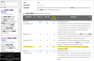

    I found the the other register, which is shown below and shows the auto negotiation status.
    The link of the above register is : https://docs.amd.com/r/en-US/ug1087-zynq-ultrascale-registers/pcs_control-GEM-Register
    I read the register, SGMII PCS control, and the value in the register is 0x1140(= 0001_0001_0100_0000) as shown below.
    Althogh the bit 12 of the register is high, which shows auto-negotiation of the MCU is enabled, the SGMII is still down.
    Philip
