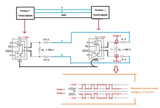

Question 1:
Base on THVD1406 datasheet description "THVD14x6 can support 256 unit load" as follow picture 1.
Does that mean THVD1406 receiver input resistance around 96K ohm?
Picture 1:
Picture 1
Question 2:
If I want to simulate and verify whether the THV1406 can support a 256-unit load (ignoring cable variables for now), can I use the following model and test environment (as shown in Picture 2)? By measuring the positions of Probe 1 and Probe 2, and if the voltage difference (VOD) reaches ±200mV or more, does this prove that my product can support a 256-unit load?
Picture 2:
Picture 2
I look forward to your reply.
Thanks.

    A complete bus can be modelled as two 120 Ω resistors (for the two terminations) and one 12 kΩ resistor for each 1 UL receiver (or 96 kΩ for each 1/8 UL receiver), all in parallel. (12 kΩ is not an exact value.) The datasheet specifies the differential output voltage for a total load of 54 Ω.

    Question 2:
    Picture 2:
    Picture 2
    The test circuit needs to have only one transmitter present. The test circuit looks like is provided in figure 7-1 of the datasheet.
    My understanding of this is the Vtest needs to be checked at 12V and -7V. You measure the VoD to be atleast 1.5V across the 60 ohm load.
    The document "The RS-485 unit load and maximum number of bus connections" shows this is done using a DC 0 to 5V supply and a -7V to +7V noise generator.
