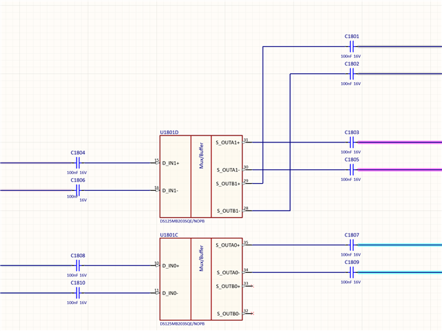

    I've noticed 0x5F[3:2]=10 disables the fanout. We use the fanout functionality for one channel D_IN1 -> S_OUTA1, S_OUTB1 as below:
    So, is it possible to keep FANOUT and turn off the RX termination?
  • Hi Nikita,
    Unfortunately it's not possible to enable fanout and also configure the input as Hi-Z. This is because input termination is programmed through the Rx-Detect mechanism which is used for PCIe applications. Fanout will not work with PCIe Rx-Detect because an end-to-end link is expected, therefore DS125MB203 does not allow the RX-Detect mechanism to be used while fanout is enabled.
    Alternatively you can power down individual channels with register 0x01 and 0x02[0], however I'm unsure if this explicitly changes the input termination. I believe the power down function simply disables the channel and all related functional blocks to reduce power consumption.
    Lucas
