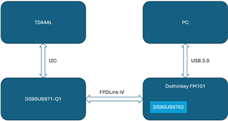

Hi Sir,
We used the following example code to enable Pattern Generator. But no any output from Dout of DS90UB971. Are there any incorrect or missing parts?
I2C between DS90UB971 and TDA4AL is ok, we can get the correct ID of  DS90UB971 over I2C.
