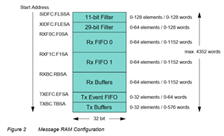

I would need some help regarding the MRAM configuration for the TCAN4550. We are using the library which is provided by TI and configure the MRAM as it is shown bellow:
TCAN4x5x_MRAM_Config MRAMConfiguration = { 0 };
/// Standard ID number of elements, you MUST have a filter written to MRAM for each element defined
MRAMConfiguration.SIDNumElements = drv_can_config->filter_len;
/// Extended ID number of elements, you MUST have a filter written to MRAM for each element defined
MRAMConfiguration.XIDNumElements = 1;
// RX0 Number of elements
MRAMConfiguration.Rx0NumElements = 5;
// RX0 data payload size
MRAMConfiguration.Rx0ElementSize = MRAM_64_Byte_Data;
// RX1 number of elements
MRAMConfiguration.Rx1NumElements         = 0;
MRAMConfiguration.Rx1ElementSize         = MRAM_8_Byte_Data; // RX1 data payload size
MRAMConfiguration.RxBufNumElements       = 0;                 // RX buffer number of elements
MRAMConfiguration.RxBufElementSize       = MRAM_64_Byte_Data; // RX buffer data payload size
MRAMConfiguration.TxEventFIFONumElements = 0;                 // TX Event FIFO number of elements
MRAMConfiguration.TxBufferNumElements    = 3;                 // TX buffer number of elements
MRAMConfiguration.TxBufferElementSize    = MRAM_64_Byte_Data; // TX buffer data payload size
What we want to achieve is to use a FIFO0 with 5 elements. The problem is that whatever number we insert, after reading the REG_MCAN_RXF0S status register, the fifo full flag is set always at 2 messages. After this we already get the message lost flag. Then we tried to configure the FIFO1 buffer, and it seems we can configure for elements up to 64. However, there we start experiencing that the filters which are set not seem to work. We experienced that a message with a specific ID is received at a random time.
Do you see any problem in this configuration?
Thank you

    The TCAN4550 only has 2k of Message RAM (MRAM) that can be allocated for the various types of elements.  Depending on your application, you may need more or less of a particular type of element and you can tailor the configuration for your needs.  However, the overall configuration must fit within the 2k MRAM block and therefore you will not be able to support the maximum number of all element types.

    I expect part of your RX Overflow issue is also due to the Filter configuration.  By default the device is configured to accept all non-matching messages and store them into RX FIFO 0.  Therefore, if you do not use message filtering, the device will by default accept and store all messages by default.
    However, if you want to use message filtering, you will need to change the values in the Global Filter Configuration Register (0x1080) so that they "Reject" non-matching frames.  This will then configure the device to only accept and store messages that pass one of your filter elements.

    thank you for the detailed explanation. It looks like some filter components influenced the FIFO0 register. Following all your guides this is now fixed. Thank you!
