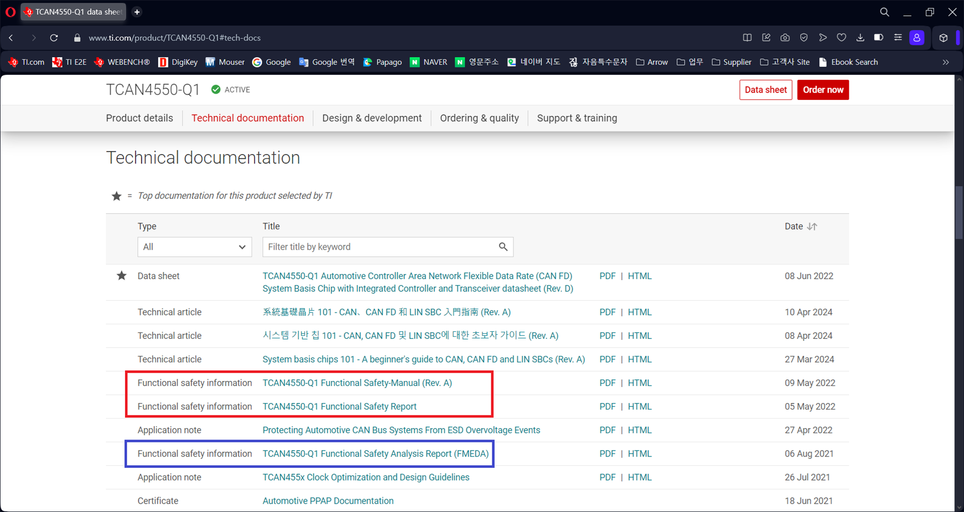

I would like to show you TCAN4550-Q1 web page, It has both "Functional Safety Analysis Report (FMEDA)" and "Functional Safety-Manual" and its report.
https://www.ti.com/product/TCAN4550-Q1#tech-docs
So Can I get the documents which is marked as red rectangle box for TCAN1463-Q1?
Chase
Hi Chase,
We do not have a separate safety manual for TCAN1463-Q1. TCAN4550-Q1 is a CAN controller + transceiver integration, that's why we have such a document to help developers integrate this device into safety-related systems. TCAN1463-Q1 is transceiver only, there is no software integrated. You can still use that TCAN4550-Q1 functional safety manual as a reference to design the system though, but I would recommend get such kind of documentation from your CAN controller supplier.

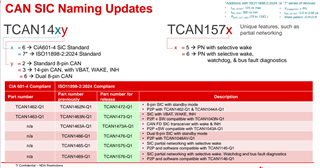

In addition, will the part number of TCAN1469DMT-Q1 be changed to TCAN1576DMT-Q1?
