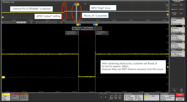

My customer is facing issue that they rarely can NOT read data via MDIO.

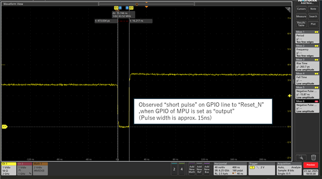

According to their investigation, they observed short pulse from MPU GPIO line to "Reset_N" of DP83867IR when they set MPU pin to GPIO output as shown below.
After observing this short pulse, even though they set "Reset_N" to low for 100 us, this issue is NOT recovered.
Then, customer have following questions.

  • Hi Machida,
    Q1)
    It's likely the device is stuck in reset state due to 15ns pulse.
    If pulsing RESET_N properly after this 15ns pulse does not pull the device out of this state, then power-cycling the device is the only remaining option.

  • Hi Machida,
    Is the above a possible event from viewpoint of device design ?
    Yes, this event occurs from device's internal state machine.

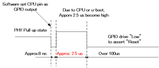

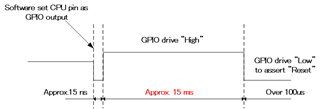

    They said when they change setting timing of "GPIO" to output too fast than previous timing, they did not observe this issue as well.
    Here is difference between timing which they observed issue and they did not observe issue.
    * Case customer observed issue (This is same as second waveform which I posted previous thread.)
    * Case customer did NOT observe issue.
    The changed point is that customer performed "Reset" as soon as possible.
    Though they still observe unexpected short pulse, however they did not observe issue after appling this change.
    However, they can not judge whether this workaround is proper. Could you comment what you think about this change ?

  • Hello Evan-san,
    Thank you for your reply.
    >1) Adding PD on RESET_N line
    Yes.
    >2) Shortening the duration of RESET pulse to 8ns.
    No. What they changed is timing when they assert "Reset" for PHY.
    For first case, they asserted "Reset" after approx 15ms they enabled GPIO[out].
    However, for second case, they asserted "Reset" soon they enabled GPIO[out].
    Duration difference of short pulse is not intentional change.
