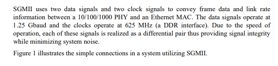

The MAC of MCU supports multiple standards:
1, SGMII without auto-negotiation: 0.1, 1 and 2.5G baud data rates with corresponding serial line rates of 0.125, 1.25 and 3.125 Gbit/s respectively
2, SGMII without auto-negotiation: 0.1 Gbps data rate with corresponding serial line rate of 1.25 Gbit/s
What standard should DP83TC812S-Q1 be set to interface such MAC?
Thanks!
