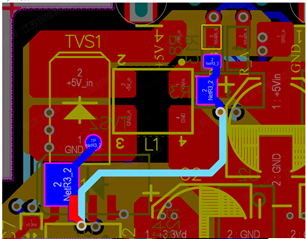

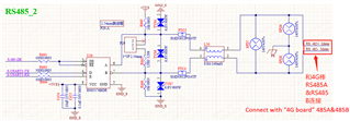

These are the schematic and PCB of customer’s board, there are two positions need 485, one is ” 4G board”, another one is ” power board “.

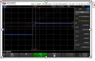

Customer used NCA3176 at ” 4G board”, and used SN65176 at ” power board “. Now we find there is a voltage drop at the 485 signal rise edge while use ” 4G board” send 485 signal to ” power board “. But there isn’t voltage drop while use ” power board “ send 485 signal to ” 4G board”. The signal rate is about 115200.

  • RS-485 is a differential protocol. What matters is only the voltage between the two lines; tell the oscilloscope to compute A − B. Does the problem still show up?

    • Is this voltage drop creating communication issues, or is the customer just curious as to why it is occurring? Depending on how long the voltage drop duration is, the sampling point should be after this fluctuation and might not be a problem.
    • Could you please share more info about the voltage drop? Please share waveforms of A and B with a math channel calculating A-B.
    • Please probe VCC when the voltage drop is present. I am not seeing decoupling capacitors so try adding these to the NCA3176/THVD1420.
    • Are there 120 Ohm termination resistors on both devices? I see the P29 connector on the power board. Ensure that the this is closed so that 120 Ohms is on both sides.
