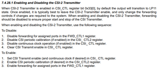

         We are working on SerDes(DS90UB953TRHBRQ1/ DS90UB954), as of now SerDes has been interfaced with IMX8mplus.
Interface Details:
                2 Serializers(DS90UB953TRHBRQ1) connected to 1 Deserializer(DS90UB954) sharing 2 lanes each.
                And this Deserializer is connected to IMX8mplus with through MIPI CSI-2 Interface.
                Can we know how to enable and disable Deserializer without powerdown?
