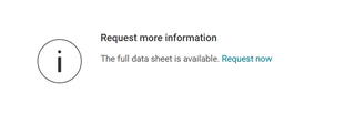

Hi Darshan,
The recommended supply voltage range maxes out at 28V and the absolute max voltage on the supply is 40V (but no guarantee of proper operation past 28V).
For datasheet please go to product page and click on the box that says request and if approved you will get the full datasheet.
Box shown below for reference:
