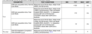

(1) the time it takes for the PLL to lock
(2) the time it takes for the PLL to unlock
in both "Lock Mode" and "Non-Lock Mode".
And does this change depending on the transmission rate or register settings?

    1. In lock mode (CDR mode), the CDR lock time is dependent on the adaptation mode used.  For adapt mode 2, we expect <100ms.
    I don't have measurements on the unlock time, but I would expect it to be very quick, <1ms.
    2. In non-lock mode (I'm assuming you mean CDR bypass mode), there is no lock time.
    The CDR lock time will be most significantly impacted by the CDR divider setting.  For example, I expect the lock time for 10GbE (10.3125 Gbps) to be longer than 25 GbE due to increased adaptation time.
