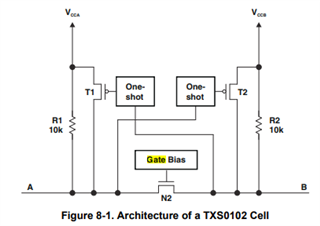

    TXS0102 Vil = 0.15V - VERY LOW - for A side and B side.  Driver current is not spec'd though with pullup accelerator a small pullup is unnecessary.    Please confirm
    TXS0102 is different architecture than the TCA9517 and TCA9617B. TXS0102 is not a true buffer. It is a passFET between side 1 and side 2 while a buffer exists between A-side and B-side of the 9517 and 9617B buffers.
    TXS0102 is a passive device. The "re-drive" aspect comes from the rise-time accelerators (one-shot accelerators) present within the device.
    VIL = 0.15V is the input low voltage that the device was validated with in the datasheet. In practice, a VIL could vary depending on the low-side voltage supply.
    The gate voltage of the passFET is set to approximately one threshold voltage (VT) above the low-side voltage. Thus is VCCB = 5V and VCCA = 3.3V, this means that the gate voltage is roughly 3.3V + 0.7V = 4.0V. A-side of the TXS0102 will begin to track B-side once either side falls a VT below the gate voltage.
    See the architecture of the TXS0102
