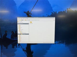

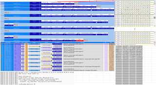

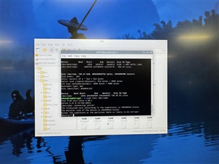

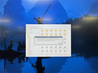

  • Hi Nicholaus,
    Thanks for the reply.
    This has to do with the link.
    I attach the image data of the situation.
    success
    success
    failure
    failure
    Ryu.
  • Hi Ryu,
    Does the screenshot show the returned value of sg_raw?  I see a response that says, "SCSI Status: Check Condition" and a response that says "SCSI Status: Good".  What number value does this correspond to on this page?   Exit Status Descriptions - sg3_utils(8) - Linux man page
    The commands in the screenshots don't seem to match to me.  It looks like the transfer length is incorrect. I'm still reviewing the data.  Give me a little more time today and I will follow up.
    Nicholaus

  • Hi Nichoaus,
    The log is attached.
    [2025-03-19 17:00:43.925] sg_raw -v -s 512 -i SET_auth.bin /de/ v/sda a1 0a 25 00 00 00 00 00 00 81 00 00
    [2025-03-19 17:01:42.497]     cdb to send: [a1 0a 25 00 00 00 00 00 00 81 00 00]
    [2025-03-19 17:02:02.715] [22991.182905] usb 1-1.2: reset high-speed USB device number 3 using ci_hdrc
    [2025-03-19 17:02:02.831] >>> transport error: Host_status=0x03 [DID_TIME_OUT]
    [2025-03-19 17:02:02.831] SCSI Status: Good
    [2025-03-19 17:02:02.831] Some other error
    [2025-03-19 17:02:02.841] root@imx8mn-ddr4-evk:~# echo $?
    [2025-03-19 17:02:10.491] 99
    [2025-03-19 17:02:10.500] root@imx8mn-ddr4-evk:~# sg_raw -v -s 512 -i auth_device.bin /dev/sda a1 2a 25 41    51 00 00 00 00 00 81 00 00
    [2025-03-19 17:02:51.002]     cdb to send: [a1 2a 25 51 00 00 00 00 00 81 00 00]
    [2025-03-19 17:02:51.010] SCSI Status: Check Condition
    [2025-03-19 17:02:51.010] Sense Information:
    [2025-03-19 17:02:51.010] Fixed format, current; Sense key: Recovered Error
    [2025-03-19 17:02:51.012] Additional sense: ATA pass through information available
    [2025-03-19 17:02:51.020]   error=0x0, status=0x50, device=0xa0, count(7:0)=0x0
    [2025-03-19 17:02:51.040]   extend=0, log_index=0x0, lba_high,mid,low(7:0)=0x0,0x0,0x0
    [2025-03-19 17:02:51.040]  Raw sense data (in hex), sb_len=18
    [2025-03-19 17:02:51.040]         f0 00 01 00 50 a0 00 0a  00 00 00 00 00 1d 00 00
    [2025-03-19 17:02:51.040]         00 00
    [2025-03-19 17:02:51.040] Recovered error (warning)
    [2025-03-19 17:02:51.048] root@imx8mn-ddr4-evk:~# echo $?
    [2025-03-19 17:02:58.267] 21
    [2025-03-19 17:02:58.276] root@imx8mn-ddr4-evk:~#

    It looks like the TUS9261 is being reset after attempting this command.  Can you capture a USB protocol trace and see if that is the case?
    I did not know how to implement this one.
    Ryu.
  • Hi Ryu,
    Since the host is timing out, it is difficult to debug without seeing what the host is doing on the USB-side.  There is equipment that will capture the USB protocol messages.
    Beagle USB 480 Protocol Analyzer - Total Phase
    USB-T0S2-A01-X Teledyne LeCroy | Test and Measurement | DigiKey
    Are these available?
    Nicholaus

    I totally understand, sorry about the wait. While I was working on getting a motherboard setup for Linux, I was able to find a Raspberry Pi with Raspbian installed on it, so I went ahead and gave that a try with the customer provided SSD via an NVME M.2 enclosure.
    With that Raspberry Pi, I was able to see the SSD show up, however, I was given this error once it was detected/attempted to mount:
    I tried to check what this might indicate (I'm not too familiar with Linux), and after sending some commands through the command window, I got this:
    It looks like the SSD may be corrupted, and may need to be reformatted. Is it possible this SSD may have been corrupted? Or does the customer believe this may be a setup issue?
    If the SSD does need to be reformatted, is that okay, or were there important files on the SSD? Any specific instructions from the customer?
    Ryan

    I received the SATA to M.2 enclosure, and I was able to see the SSD appear on host PC:
    This is what appears when I look at the SSD on the host, so I wanted to confirm this is whether this is what was expected to be found, or if there are meant to be files here that are not present.
    Additionally, I did try to open this "lost+found" folder, but I was meant with a "permission denied" error.

    I tried to get some testing done on this today, however I was running into some issues. Namely, when I would try to send any of the commands listed in the test environment, I would receive errors with using the auth_device.bin, saying it was an unknown command byte when listing the device directory. To go off of that, from what I can tell, our device directory is /media/admin. I don't see a /dev/sdX associated with it. Am I missing it somewhere, or is there potentially an issue in the setup there?
    I'm not the most familiar with Linux commands, so an explanation of what this command is meant to do may help. My current assumption is that it will send the attached file, like auth_device.bin to the SSD.
    Additionally, I tried to manually move these files to the SSD via the file manager on the host, however I was met with a 'permission denied' prompt. This should not be the case, correct?
    Ryan
