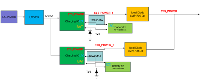

As below block diagram, we need the hot swap function for two batteries with I2C interface.
1. Is I2C Buffer TCA9511A necessary?

The TCA9511 isolates the how-swapped bus from the rest of the bus to allow communication between the remaining devices to contiue. If the only devices on a single bus are the charging IC and the batttery, then you do not need this isolation.
Hi Jesse,
As Clemens mentioned already, TCA9511A separates the "IN" and "OUT" sides in a hot-swap event. TCA9511A would be useful here if the Battery#1 and #2 modules are being hot-plugged into the system. Otherwise, TCA9511A is not needed here.
Tyler
Thanks. I want to confirm if my understanding is right.
When hot-plugged event happen, if I need the whole I2C communication between charging IC and battery to get correct data, then TCA9511A would be useful. If I don't care the I2C communication when hot-plugged, TCA9511A is not needed .
Is my understanding right? Thanks.
Hi Jesse,
TCA9511A would help to prevent a stuck bus condition due to a hot-plug event. If TCA9511A is not used, and a stuck bus event occurs due to hot plugging, then the I2C target devices connected to the bus would need to be reset.
Yes this is true. IF you run into a hot-plug event that causes a stuck bus condition, then you would need to reset the state machines of each target device / controller device on the bus.
