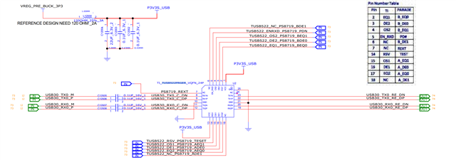

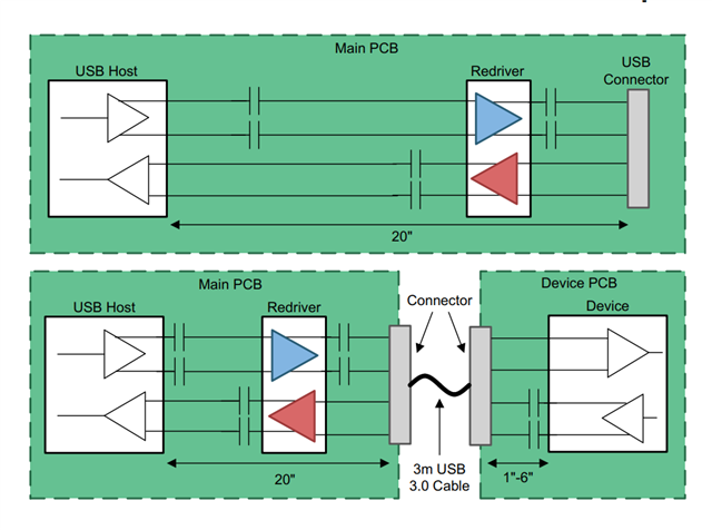

Hi, we are try to replace the PS8719 to TUSB522PRGER, but the PS8719 have a limit which is Host port and Device port are fix in separate direction. I wondering the TUSB522P have similar situation. Please refer to the picture2 which is our design, USB30_TX0_RE & USB30_RX0_RE are connect to USB Connector, USB30_TX0 & USB30_RX0 connect to Host.
