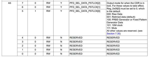

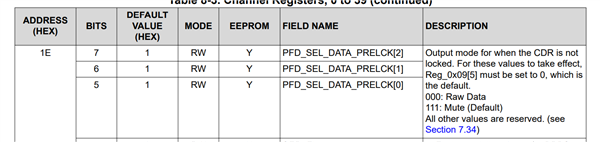

  • Hi Drew-san,
    Let me change the question as below.
    In "8.2 Functional Block Diagram" in the datasheet,
    it says that you can switch between Raw, Retimed, and PRBS with a selector,
    but can you select Retimed even if the LOCK is released?
    Thanks for your kind support.
    Takumi
  • Hi Takumi-san,
    Register 0x1E[7:5] controls the output MUX when CDR is not locked.  Register 0xA5[7:5] controls the output MUX when CDR is locked.
    Looking at 0xA5, 3b001 selects retimed data as output.  You can try setting the same for register 0x1E[7:5], but this is not supported by TI and I'm unsure what the output would be.
    Drew
  • Hi Drew-san,
    Thank you very much for your reply and sorry for my late response.
    Let me understand your answer as below,
    So if we set the 1E[7-5] register to "001" as the same as A5[7-5] settings that enable output "retimer data", the output signal data is unknown.
    This means that TI cannot guarantee the output data in case of 1E[7-5] setting is "001", and that users should not use this setting even though something signal is outputed.
    Is my understand correct?
    Many thanks for your kindness.
    Takumi
  • Hi Takumi-san,
    Yes, your understanding is correct.
    Drew
