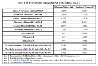

  • Hi Colin,
    CC negotiation is done on the CC1 and CC2 pins.
    A DFP will always have terminations to 3.3V or 5V through resistor Rp, or serve as a current source
    A UFP will always have terminations to ground through resistor Rd.
    A DRP will switch between a DFP termination and UFP termination in a periodic manner.
    The negotiation is done almost instantly and the steps are closer to being performed in parallel rather than sequentially.
    1) Determine orientation of cable by seeing which CC pin is pulled to a voltage over the detection threshold.
    These are the thresholds for all DPF terminations.
    The resistor value used are as follows:
    2) Determine the current sourcing capability on the Vbus using the resistor values on the CC pins.
    3) Supply Vbus
    This is how the CC communication works.
    If the device is unpowered without Vbus, this is called dead battery mode. In this mode the port cannot be a DRP or a DFP. It can only be a UFP.
