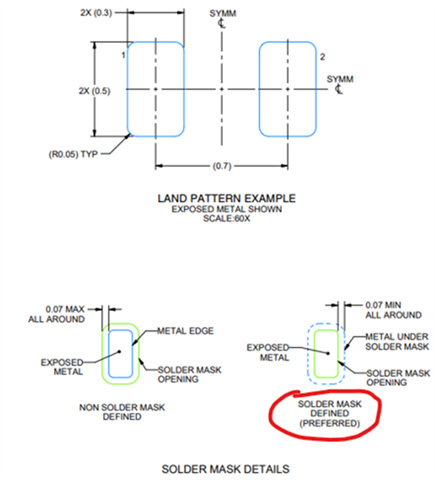

On solder-mask defined what should the pad size of ESD401DPYR be?
According to our customer,
This appears to be confusing. It appears out customer on their PCB has the Solder Mask Opening smaller than the recommended PAD size.
I just need our confirmation on PAD size as SMD and NSMD, which I would think should be the same.
