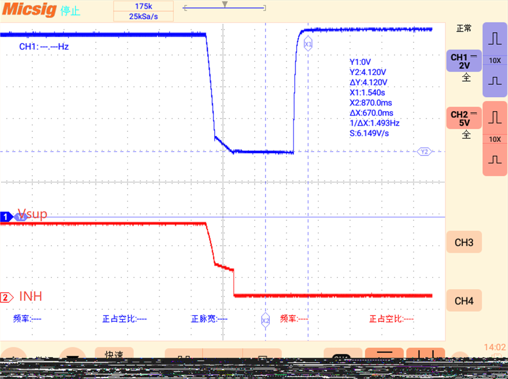

When I shut off the Vsup from 12V,the voltage fall to 4.12V,INH do not output,and then turn the power on,Vsup rise to 12V,but INH do not pull to high.Is it normal?
We use INH to enable PMIC IC with wake pin,and PMIC will be turn off if wake pin below 5V(INH in here)

    Based on the current description, the device is entering a protected mode since it is below UVSUP. Please refer to UVSUP in the Power Supply Characteristics section and Section 8.3.8.4 of the datasheet for details on UVLO.
    Once VSUP returns above UVSUP rising (~4.4V), the device is in Sleep mode.

    When TCAN1043A is inside the UVSUP(falling) and UVSUP(rising) range which is from 3.5V to 4.4V, the device is in a protected mode. In protected mode, the device functionality is disabled and high impedance. Table 8-4 shows this. ICC in protected mode is not mentioned in datasheet, but it will be less than 5uA.
    The mode that TCAN1043A returns to after an undervoltage events depends on how low the voltage went. If VSUP drops into UVSUP range from 3.5V to 4.4V, the device will be in Sleep mode once VSUP is returned to a proper voltage (>4.5V).
    However, if the voltage drops below UVSUP range, which is less than 3.5V, then the device will reboot and enter the "Power on" sequence. This is effectively a cold start, and the device will enter into Standby mode and likely Normal mode after VSUP is above 4.5V.

    INH can go back to high after VSUP drops into the UVSUP range. It just needs the right configuration to help it switch modes.
    INH is related to the mode that TCAN1043A is in. If VSUP drops into the the UVSUP range (but not below this range), then after returning to a valid VSUP voltage then device will be in Sleep mode (which has INH low). Please reference Figure 8-4 in the datasheet. TCAN1043A can be woken up using a variety of methods which will restore INH to high (particularly Standby, Normal, and Silent mode).
    This protection mode is a feature that keeps the bus and logic lines high impedance when there is an abnormality with VSUP. This prevents any damage from taking place when the voltage levels are unknown.
