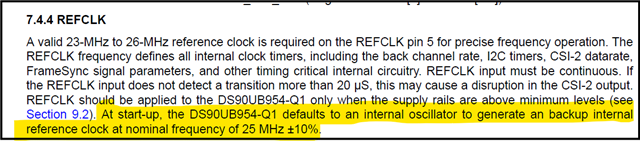

As per the datasheet of DS90UN954-Q1, it internally generates 25MHz clock initially as a backup. We are using in synchronous mode.
Is there a way, we can use DS90UB954-Q1 from internal oscillator only? I want to remove to external resonator.
    Using reference clock for UB954 is mandatory, the oscillator must be used to provide an accurate and stable reference clock source to keep the link stable.

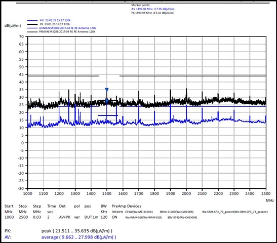

    We are facing issues in radiated emission and getting harmonics of 100MHz and from sniffer probe we detected that UB954 clock circuitry is the main contributor for that. Can you please help me in any regards?
  • Hi Sevender,
    Could you provide more details on this? What frequency are the limits being hit? By how many dB are the limits exceeded on your syste?
    Thomas
  • Hi Thomas,
    Please see the attached image for your reference. A small guidance will help a lot.

    Are you sure that the FPD-Link devices are the source of the EMI/EMC disturbances? The spectral separation between the peaks is about 100MHz. But if you are in Synchronous Mode and using a 25MHz REFCLK at the 954, then we expect the spectral separation between peaks to be roughly 770kHz.
    If you cover the DOUT+/RIN+ traces on the PCB with copper tape and connect the copper tape to GND, does that reduce the spikes?
    Is it possible that the 25MHz oscillator is the source of the spikes? Can you use an oscillator with a lower drive strength, or add a small series resistor between the oscillator output and the DS90UB954-Q1 REFCLK pin?

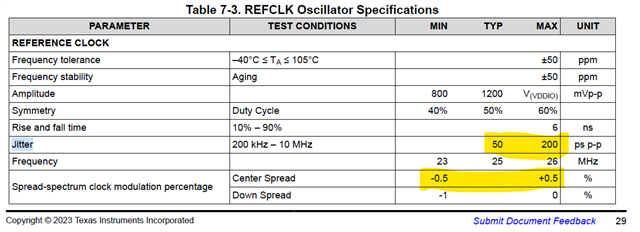

    One more point I want to know regarding clock here is
    Allowed Jitter is 200pS but spread spectrum can support upto +-0.5%. So if I am using 25MHz SS oscillator then the freq. variation will be around 125KHz in both side.
    The total time variation across the defined time period (25MHz clk) is approx 4uSec which is quite higher than the accepted Jitter value 200pS.
    Can you please help me to understand the gap here.

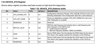

    If the concern is whether the 954 is utilizing the input from the oscillator, then you can poll register 0x04 in the 954 device and confirm that the REFCLK_VALID bit is always set to 1.

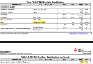

  • For the oscillator jitter spec, the Test Condition is between 200kHz - 10MHz. The SSCG modulation frequency is 33kHz (max).
    If you measure the jitter of the REFCLK input in the frequency BW of 200kHz - 10MHz, then the spread spectrum modulation frequency will be excluded from the measurement.
    Customer needs to confirm separately:
    1. The jitter from the oscillator (in the BW of 200kHz - 10MHz) is 200ps pk-pk (max)
    2. The SSCG modulation percentage is within +/-0.5% Center Spread or -1% Down Spread
    3. The SSCG modulation frequency is 33kHz (max)
    All conditions can be met.
    Justin Phan

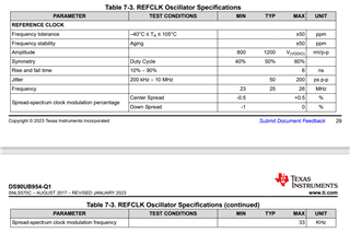

    1. The SSCG modulation percentage is within +/-0.5% Center Spread or -1% Down Spread---> we are using +-0.1% center spread oscillator. see below
    2. The SSCG modulation frequency is 33kHz (max) ---> This freq. is not mentioned in the oscillator specs. I am still not clear about the impact of this freq. of modulation on Jitter.
  • Hello Sevender,
    The SSCG modulation frequency is the rate at which the clock frequency is varied. If you measure the jitter of the oscillator in the BW of 200kHz - 10MHz, then the SSCG modulation frequency should not appear in your measurement.
    It is possible to meet the jitter spec with SSCG applied, since the BW of jitter excludes the fmod of SSCG.
    1. Yes, +/-0.1% center spread is supported by our device.
    2. The modulation frequency (fmod) is typically between 30kHz - 40kHz, but you need to confirm that it is less than 33kHz in the oscillator datasheet, since our device can only support up to 33kHz modulation frequency.
