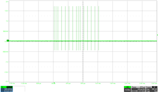

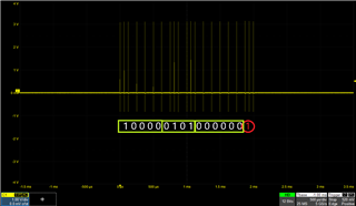

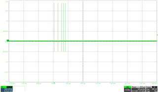

we are using DP83822 and we notice active "next page" bit on the autonegotation bitstream.
Here is measured bitstream from DP83822
Last bit is "next page" and it is "1". But in register 0x0004 (Auto-Negotiation Advertisement Register (ANAR)) we have "0".
Why MAC send "1" when we need "0" on this bit?
And here is dump of almost all registers (odds positions are register number, evens are value) Register 0x0004 is in red circle. Value in this reg is 0x0141 (next page bit == 0)

    The issue was caused by our software, which did not wait long enough for the auto-negotiation to complete and attempted to restart it prematurely. As a result, the DP83822 started transmitting auto-negotiation data via Fast Link Pulses (FLP) in an inconsistent state. It appears that the PHY's internal state machine continues running independently, and if it is reconnected to the link at an arbitrary point, it may send truncated or invalid advertisement data, making the situation worse.
    I am attaching an image illustrating how the auto-negotiation data gets truncated when the PHY is reconnected mid-sequence.
    Here is an example:
    * Only the last 3 bits from auto-negotiation data were transmitted.
    The first 12 bits of the next auto-negotiation frame are incomplete.
    Now it works, but there are still two open questions:
    1. Why does the DP83822 send "Next Page bit" = 1, when the configuration register is set to "0"?
    2. Why can the DP83822 transmit invalid/incomplete auto-negotiation data?
    Jiri

    If the PHY were not restarted abruptly, would this behavior still be present? Can you please provide a screenshot of the FLP for this codeword in this behavior? Is all codewords showing next page when in normal communication? The abrupt reset may be putting the PHY into an unknown state.
    How is the PHY getting reset? Is it via HW pin or via register? How long is the reset asserted for if via pin? My expectation would be that communication ceases upon a reset in order for the PHY to properly reset.
