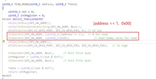

1. Could you help to explain the configuration command?
Do read and write commands send two bytes of data in the configuration command? How do we combine the hardware address and the command word? Just send it out?
2. Is there a problem with configuring the following command words?
such as reading the current mode configuration of the transceiver, sending [0x10<<1, 0x00], configuring the current mode of the transceiver to normal mode, sending [(0x10<<1) | 0x01, 0x07];
3. Does the MCU need to prioritize configuring the initial working mode after the transceiver is powered on?
  • Hi Fabio,

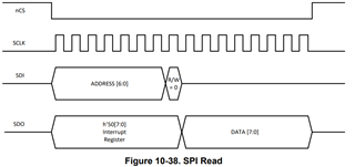

    It looks like your understanding here is correct. The configuration command above for a read first constructs the first byte using the 7-bit address shifted left and the read/write bit (0 for read so left as-is). The data in the second byte is irrelevant, so 0x00 is sent in order to generate the signal on SCLK for the transceiver to respond with the read data. In the figure below, the flag line on SDI after R/W is this 0x00 being sent by the controller and is ignored by the transceiver.
    Sending the bytes [(0x10 << 1) | 0x01, 0x07] is correct for a write command (ORing with 0x01) to the mode control register (address 0x10) to set the device to Normal mode (111b = Normal).
