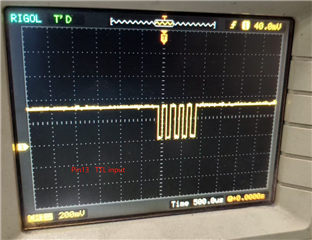

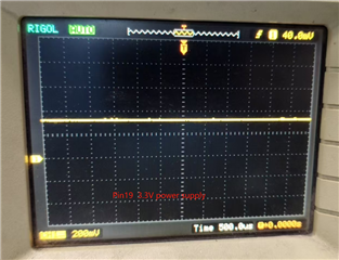

The test found that there is signal input in Pin12/13, but no signal output in Pin17/18. After replacing the chip, the recovery is abnormal. Please kindly check the cause, thank you

Please configure your oscilloscope correctly; this looks as if you're using a ×10 probe with a ×1 input.
The charge pumps appear to work correctly, but the output is near GND. Is there anything connected to either connector? Are the voltages measured at pins 1/14/20 what you expect?
I do not see any reason for concern from your schematic. Please follow up with Clemens questions, and ensure you are following the datasheet driver inputs correctly:
Any additional information and details would be helpful. A picture of how you are probing the device would also be helpful.
