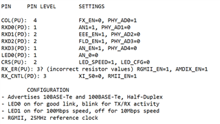

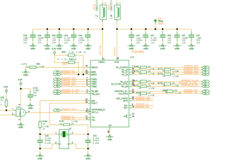

I want to know bootstrap configuration for the below resistor combination
Part Number: DP83822H
Hi Akash,
Here is the bootstrap configuration the DP83822 would be in given those settings:
Your resistor values on RX_ER are incorrect for a bootstrap with internal pullup. For level 3 you should use a pullup of 6.2K and pulldown of 1.96K
Shane

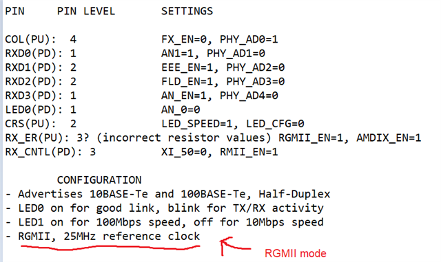

Thanks Shane,
To confirm Bootstraps configuration, The resistor combination used is RGMII mode with 25MHz clock. Please confirm
Yes you are configured for RGMII mode with 25MHz clock. Please see the image in my previous response:
Hi Subhash,
For RMII master mode, you need to set RMII with 25MHz reference clock.
To set this, use the following Pullup/Pulldown combinations on RX_ER and RX_DV:
