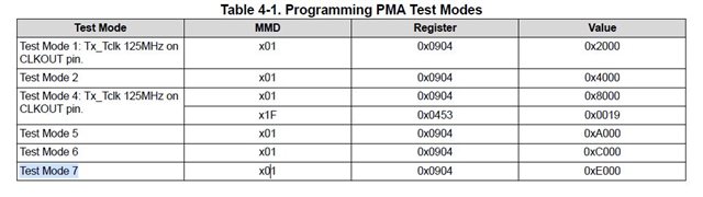

I want to find a way to read the BER. In PMA mode, the test mode 7 should be selected shown in 4.1 PMA Testing Procedure in the datasheet.

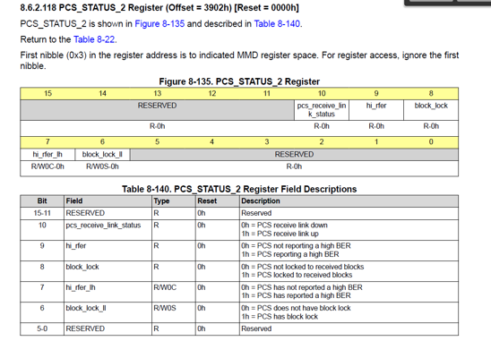

According to 802.3bp, the BER count can be read via bit 5:0 of the PCS status 2 register. However, these bits of PCS status 2 register of this PHY are reserved.
Is there any way to evaluate the BER of this PHY?
