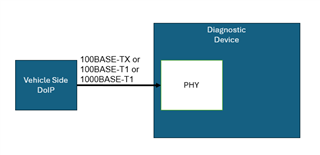

    Just to double confirm, I am looking for a single PHY for my design supporting all three: 100BASE-TX, 100BASE-T1 and 1000BASE-T1. does such solution exist?
    1) If yes, can you please share the part details and references.
    2) If not, is it possible to add a switch and use two different PHY to support all three?
    Sharing additional information for our requirement,
    Below is high level diagram. We are targeting to use PHY device in Diagnostic device. Vehicle side DoIP interface can be 100BASE-TX or 100BASE-T1 or 1000BASE-T1. And to align this requirement we need to have support of all three categories.
    Thanks for your support,
    Nikunj
  • Hi Nikunj,
    We don't have a product in our portfolio that can support all three of these protocols.
    We have not tried using a switch to allow one set of data lines to interface with multiple PHYs so I can't comment about whether this is possible or practical. I'd like to note that the 100BASE-TX protocol has different physical and signaling characteristics from the -T1 protocols, for example by the use of two twisted pairs instead of one and a different DC isolation scheme, so it could be rather difficult to use a switch scheme to share a datapath between both -TX and -T1 protocols.
