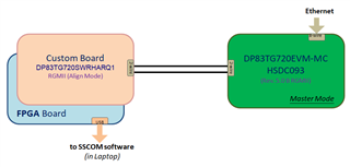

Our team is evaluating the DP83TG720R-Q1 Ethernet PHY using a custom-designed board and the DP83TG720EVM-MC evaluation board.
The setup is as follows:
  1. Evaluation Board (EVM) Connection: The DP83TG720EVM-MC is connected to Ethernet.
  2. Custom Board Setup:
    • The custom board also uses the DP83TG720R-Q1.
    • The custom board is connected to an FPGA, which serves as the MAC interface.
    • The FPGA is connected to a laptop via USB, and SSCOM software is used to monitor communication.
  3. PHY ID Recognition:
    • The PHY is correctly detected in SSCOM, meaning the MDIO interface is working.It gives following msg:
      Configuring network interfaces...ZYNQ GEM: ff0e0000, mdio bus ff0e0000, phyaddr 0, interface rgmii-id
      [17:32:49.368]IN¡û¡ô[ 7.669787] macb ff0e0000.ethernet eth0: PHY [ff0e0000.ethernet-ffffffff:00] driver [TI DP83TG720CS1.1] (irq=POLL)
      [ 7.680170] macb ff0e0000.ethernet eth0: configuring for phy/rgmii-id link mode
    • However, communication does not happen, or if it does, it lasts for a very short time (~10 sec).

 DP83TG720_Custom Board.pdf
I have attached the schematic for your reference.

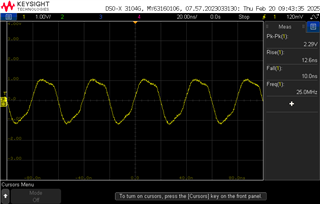

  • Hi Drew,
    Thank you for your suggestions. We have conducted the following tests based on your recommendations:
    1. XTAL Capacitor Verification:
      • We have confirmed that our oscillator (CX3225SB25000D0FFFCC) requires a C_L range of 6pF–10pF, and we are using capacitors that match this specification.
    2. Oscillator Stability (XO Pin Scope Measurement):
      • The oscillator stabilizes instantly upon power-up.
      • We have attached a scope capture of the XO pin for your reference, the measured value is also shown in the scope reading.
    3. Multiple Board Testing:
      • We have tested multiple boards, and the same link instability issue persists across all of them.
    I think, the oscillator seems to be functioning correctly, what do you think?
    we would appreciate your guidance on what to check next.
    Somnath
