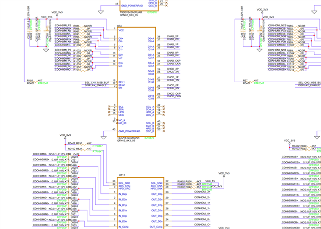

Hi
In our design, we connect the HDMI connector via AC capacitors , to the TS3DV642 MUX component, and we connect the MUX output to the SN75DP159 inputs  without AC capacitors, and we connect the SN75DP159 output to the TS3DV642 MUX input. We checked all the SN75DP159 pins and everything according to the DATASHEET,
There is a video signal at the input to the SN75DP159 , but all the video outputs signals are at 0 volts.
I checked all the voltages for the component with an oscilloscope, both 3.3V and 1.1V are all normal. I checked the quality of the video signals at the input, the signals are as expected.
The component is in pin configuration mode and not I2C configuration.
What could be the reason for this?

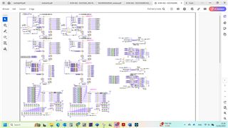

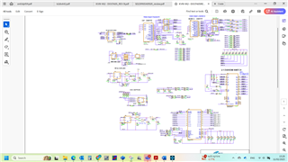

Attached the electrical schematic.  KVM 4X2 - DOCF605REV02.pdf
