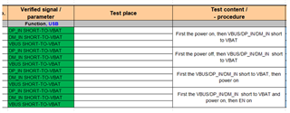

Could you help confirm whether TPD3S713 could support below test items.
BTW , could you also help confirm whether TPD3S713 & TPS25830/25846 could support overcurrent over DP, DM pins ? seems like they are not able to provide it.

    The TPD3S7130Q1 does provide the requested items.
    I am not aware of any system that requires over current support for DP/DM.  The pins are signal pins and do not support power delivery, so there is no need to over current protection.
