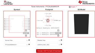

i cant able to find out footprint dimensions information in datasheet please provide datasheet with dimensions

Hi Aravind,
You can use the UltraLibrarian tool to look at a detailed view of an example footprint:
This would help with layout of the device.
I understand your concern here. The RSV16 generic package view does not provide details on the actual dimensions.
The TI package search tool has the following information:
Page 34 of the TMUX1209 datasheet has the dimensions for the RSV0016A package. This should be the same as the TCAL9538
