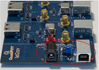

Hi, Support Team
We saw the TUSB216-1 datasheet of 8.2.2.1 Test Procedure to Construct USB High-speed Eye Diagram
about 8.2.2.1.2 For a Device Side Application:
Q1: Connect a USB host, the USB-IF device-side test fixture, and USB device to the TUSB216-Q1. Ensure that the USB-IF device test fixture is configured to the ‘INIT’ position
What is mean INIT position?
Q2: Allow the host to enumerate the device
How to Allow the host to enumerate the device?
if any suggestion, Please advise me.
Lawrence
  • Hi Lawrence,
    This applies to certain test fixtures, which have a TEST and INIT switch. Not all test fixtures have this switch, this is more so meant just for the ones that do. An example is the fixture below:
    This should automatically happen, this step just indicates to give it time to enumerate at the host before beginning to send packets.
    Please let me know if you have any other questions.
    Thanks.
    Ryan
