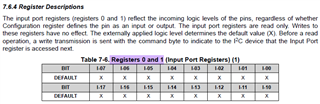

    Regarding the datasheet, the sentence below is written.
    "Resetting the interrupt circuit is achieved when data on the port is changed back to the original setting or when data is read from the port that generated the interrupt."
    When data is read from the port geneated the intrrupt means the registers 0x00h and 0x01h are read. Is my understanding correct?
    After resetting the interrupt circuit, the INT output gets HIGH. Is my understanding correct?

  • Yamamoto-san,
    If input port register 0 - 0x00 caused the interrupt, and you read input port register 1 - 0x01, then the interrupt will not be cleared. The interrupt will only clear if the 0x00 register is read.
    Correct. After resetting the interrupt circuit, the INT output releases HIGH to indicate that an interrupt is no longer being asserted. This requires a PU resistor on /INT.

  • Yamamoto-san,
    Interrupt may clear if only 0x00 register is read.
    If register 0x01 caused the interrupt, a read of register 0x00 will not clear the interrupt.
    To ensure that interrupt always clears, it is best practice to read both registers 0x00 and 0x01.
